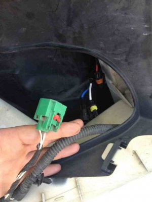

I just thought of something, I want to make sure I'm not the only one with the hid harness set up like this.
Battery is on driver side, therefore the driver side green factory headlight plug is used to plug into hid harness.
But what about the pass side green plug? Mine is just sitting there not plugged into anything.. Is that how it's suppose to be?
This is the passenger side factory plug for the headlight, nothing has been plugged into it since day 1 of hid install

Thats how its supposed to be, the only thing the plug on the drivers side does is give the relay the signal to close and allow power to the headlights (direct from the battery which is why you have it hooked up there). Also, that green plug on the drivers side should be where you're using your multimeter to test for power with just the low beams on.
