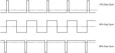

Three words pulse width modulation.
Almost makes me sound clever. Just don't ask me what it means lol
Sent from my SM-N910T using Tapatalk
PWM equates to rapidly turning a light bulb on and off. So fast the incandescent light doesn't have time to fully cool off. So the naked eye can't see it. Supposed to extend bulb life. Looks like this on a service monitor.
If you took out PWM it would be a straight line. Nice and clean for an LED. But we can't have that in our RAMs. [emoji53]
Oscilloscope should show the signal, probably occurs only when engine running. Isn't that what causes the blinking of hid's and led's on the later Ram's? I read a good article about it on a wrangler or jeep forum.

You are correct on your last reply. It's the Bain of electrical modifications to our RAMs. I think I read that same article. If not that exact one a very similar one. Cleaned up a few misconceptions.
And as many articles and threads I have read ( this thread and the OPT7 thread to name a few) I can't remember what has been said by who on what thread. So it may have been discussed already. But it is good to post that article up for a refresher or to bring to light for new followers that didn't read all the pages of these threads.
So thanks for posting. It's a good article everyone should read who is attempting any electrical work in their RAM.

Yeah, I'm going to read it again, as I only read the first page detailing the information given.
My led light pods attached to my fog harness slightly flicker, very faint but enough to probably greatly reduce its lifespan. I bought an OPT7 capacitor flicker free harness hopefully that'll fix it. Or should I say band aid it. Lol.
I'm wondering if there is way via a programmer to disable this function on our trucks. , I'm sure there is a way but not available currently or feasible.

The capacitor harness should fix your flicker problem. And honestly all of our fixes are band aids.
Would be awesome if there was a way to reprogram but somehow I don't see that happening. I would only imagine it requiring a major computer program revamp. Certainly above my pay scale. Probably along lines of Chrysler computer programers.
But... One can hope.
None of this would change my mind about buying a RAM but if I knew then what I know now I would have changed some things from the start or ordered from the factory everything I wanted.

Thanks for the response, appreciate it. There was mention about DRL and not being compatible with PWM, on a thread I was reading on candle forums .
http://www.candlepowerforums.com/vb/showthread.php?263719-PWM-d-voltages-for-Automotive-lighting
Longshot guess, is that person in the thread saying that DRL headlight enabled vehicles perhaps may not have PWM enabled due to the two being incompatible? Since if so, then there was a person I believe on the diesel forums having his or her dealer enable the DRL functionality on their Ram 1500. Now, I'm not sure if it disabled their PWM since that wasn't their objective.

Now that I've figured out what I'm doing with this stuff, it's really not too difficult to rectify these flickering issues with your own power ran to the battery, inline fuse, relay, and a tap of the factory wire to retain a factory switch. You'll probably still receive bulb out messages though.
If DRL turns off PWM. That would be a nice easy fix. They really should create a user interface to let the truck know what type of lighting is installed.
