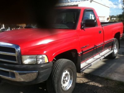

Just my High School rig I've been driving and working on lately. Not planning to do anything crazy, just get some more power, maybe a little taller, and something that looks good and is reliable.
Well, here she was when I got her.

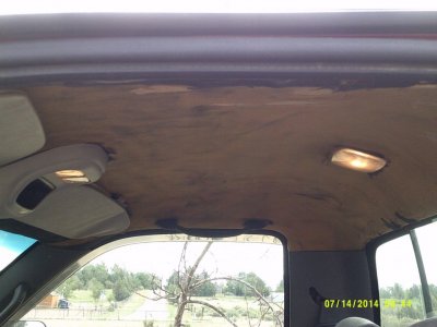

Then the most recent mod was fixing the headliner. It'd been that way since I got the truck, so it was great to get it fixed.
Before
Torn Out
Repaired
Finally Fixed
To end the headliner project, I'll take down the overhead console and paint it black. Then maybe tint the lenses and install LEDs.

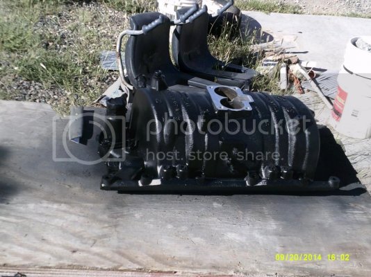

Most of you all have seen a plenum gasket repair, so I'll skimp on that.
As you can tell, the inside of it was pretty dirty. I steam cleaned it and some of it came out, but I couldn't get all of it, so just left it.
[/URL][/IMG]
Here it is in primer
[/URL][/IMG]
And here it is in Semi-Gloss Black (Yes, both are high-temp paints)
Plenum Pan on, and torqued
[/URL][/IMG]
And it in the truck, mostly together. Didn't bother with the rest of the reinstall because I was pressed for time.
[/URL][/IMG]
