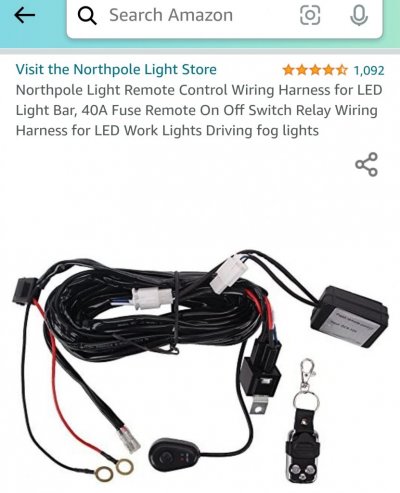

Just a side note on this. For the above it utilizes 2 channels, one for On and the second for Off. So you end up using 2 Homelink buttons if you want to turn it on and off. That kit above also has other features built in on the FOB including flash which can be helpful in an emergency perhaps.
With that said, what I want to do is find a remote control like the one above that is a LATCHING switch. This way ONE button does On & Off. I found them on the Jungle shop but haven't tried them yet so I can't recommend one yet.
