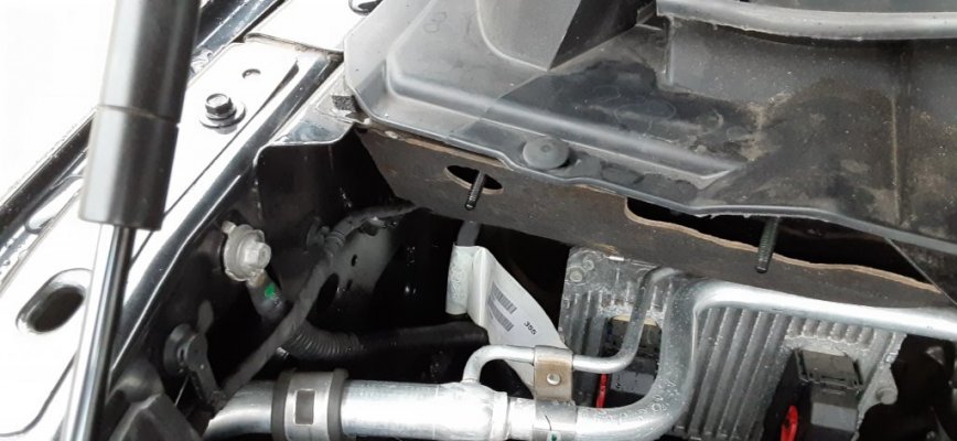

I have a 2018 Express and I don't see the plug with the cover for under hood light.

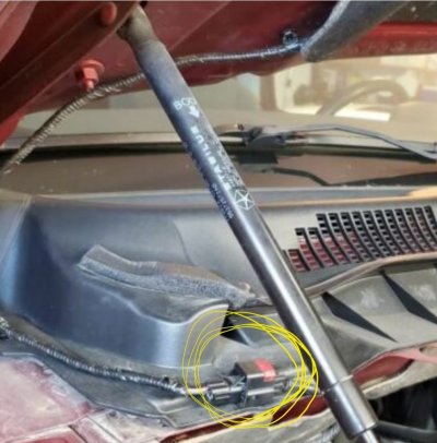

If the Express was optioned with the under hood light the harness will be on the passenger side near the hood hinge just below the windshield cowling.

Yes thanks I've tried to find part number to order missing harness anyone know the part number.

I'm curious, What month/yr was your truck built?
Maybe the Express used its own stripped down harness and that's why it doesn't have one. The plug is just 2 wires, a power and ground.
