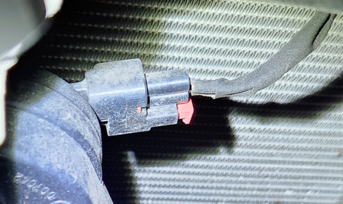

Can someone tell me the part number for this horn connector, please?
I'm replacing the horn and I want to use this connector.

Check out USCAR EV6M for the horn side and USCAR EV6F for the harness side. These are fuel injection connectors but they are used for other applications.
