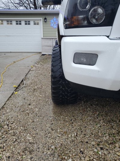

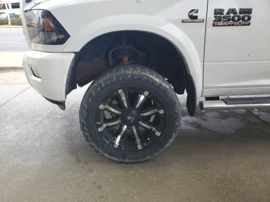

I have a 2011 Ram 3500 SRW mega cab Laramie. I'm currently running 33x12.50R20. I have a leveling kit that was on prior to me buying it. My question is can i go up to a 35 inch tire without modification to any thing else. I think my tire size is a little small. 20211224_111018.jpg

I have a 2011 Ram 3500 SRW mega cab Laramie. I'm currently running 33x12.50R20. I have a leveling kit that was on prior to me buying it. My question is can i go up to a 35 inch tire without modification to any thing else. I think my tire size is a little small. View attachment 480765
Send a picture of how far the tires stick out and I can dial in a tire for you

Yea all depends on wheel offset really. With stockish offset you can run 35’s on a stock truck and 37’s with a level.
Also, you can crank your tire full lock to either side and check for clearance, to see how much larger of a tire you can fit. Leveling the older 5 link trucks without dropping the link mounts or lengthening the links pulls the tire back toward the fender, so that is likely where it will rub first.

Looks like 10” wide wheel with a -24 offset. A 35” tire will fit. You may have to trim a tiny piece of plastic if you have the bump in the wheel well
