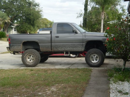

would my truck look goofy with 6in suspenison and 3in bl running 35's?

BBartow that trook looks nice. I think thats a good amount of balance between tire and lift. Ground clearance is good and all.
Honestly I think 4-6 inches is big enough for functional use.
Anything bigger is just go looks.
