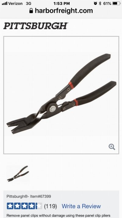

Use a trim removal tool to pop them out. Preferably the kind that operates like pliers. That type won’t damage the hood liner

Those panel clip pliers ^^^^ work fantastic.
Also, look up panel tool kit on Amazon. There are some nice kits available for cheap there.
