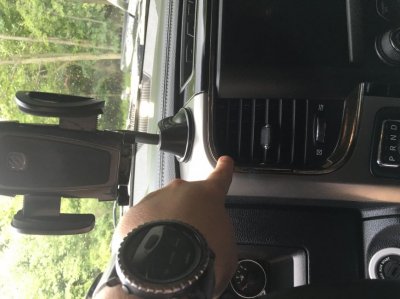

how do you remove these parts
hemi_hawk
Oct 9, 2011
460
31
the ones I am pointing at in the pix, I want to remove them so carbon fiber vinyl them

dont think the door piece can come off. You would have to take the entire inner door off to see.
outside vents, pull them out.
top of center console and vents dont really come apart from the center trim piece which is removable from the top screws one screw in the right little cubby and by pulling it off.

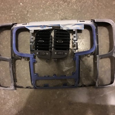

I don't have that door style (express) but the chrome around the radio is welded in. You can get a plastic welder and get them off, and re weld them when you're done. I just took off all those pieces to paint them. I unwelded them and re welded it. That upper middle portion is not removable. It is part of the "frame" if you will. The trim around the two outside vents can be popped out relatively easy. Open the glove box and push it down out of the way. You can see what you're doing on that side. The driver side I thought was harder, there is a panel you can take off when you open the door. You can then see how to get it out then. Get some plastic trim removal tools. I bought a set from oreillys for 10 bucks.
I tried vinyl around those pieces before paint. I couldnt get the vinyl to stay put. I think the A/C shrank the vinyl which pulled it back out. I used heat to get it set, but couldn't get it to stay put. I am very inexperienced with vinyl though, so it may have been me being terrible at vinyl.

the air vents didn't pull out any ideas ??
deangtp
Aug 13, 2014
208
63
It comes out. Look at it again

Like these? I gave you step by step instructions. It's not that hard. Just take your time.
