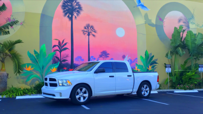

Hey there. I have a 2014 1500 R/T that I bought used a couple months ago. It is already on a 2/4 drop but I was thinking about going lower. Maybe going to a 3/5 which I am not sure how to do but was wondering how bad the ride gets. I bought the '14 because it rides better than the older leaf spring trucks I've had before.
Any help is appreciated.

My crew cab was lowered 3/5, and I thought it rode fine.
I don't think you'd notice much difference in ride with a 3/5 compared to the 2/4 you already have.
