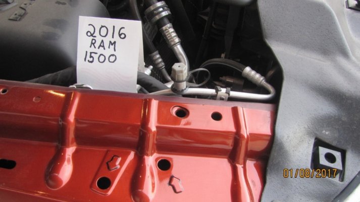

I am looking for the length I need for
T20 extended torx driver bit or screwdriver to adjust the headlights ?
Yes I know I can use a 7mm socket and extension but there is a chance the socket could fall off with my luck lol So looking for a long Torx Bit or screwdriver
Thanks

Run a piece of tape around the 7mm socket and extension so it doesn't separate.
I used a 6" extension with a 7mm, I'm sure an extended T-handle Torx would reach easily.

2 arrows for 2 different adjustment points, 2 headlight types
2009 style adjuster
2009 only has 1 adjustment point

Thank You everyone for the advice and GT Thanksfor the pictures
Update
found the T 20 and T25 Headlight screw driver at O Reilly so good to go :)
