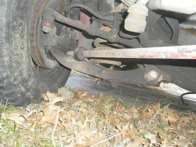

    To lower your 1st gen you can use a lot of stock Dodge parts & aftermarket Chevy stuff as well a Mopar Performance pieces. How low is how much you want to spend or work or both. These mods will work only on 100-250 series with a 3300# front axle or 1/2 lugs
    In the front you can use
    72-94 Dodge Truck with 4000# front axle LCA's single wheel or dually 1 ton
    8 lugs 9/16-5/8" 8 lugs 1/2" will not work
    You press the balljoints intended for your truck in them
    You have to drill your hangers on the frame to fit the pivot bolt hole in the LCA's bushing. 3/4"
    If you use these you can use your factory sway bar
    See the 1st pic
    78-98? Dodge van B150-B350
    5 or 8 lugs 1/2"
    On these you have to cut the steering stop off
    You have to drill the the strut rod holes
    You have to grind the arm around the bushing to fit it in the hangers
    You have to drill the hangers to fit the pivot hole in the bushing 3/4"
    You press balljoints intended for your truck in them
    If you order these LCA's off ebay the balljoints that come in them will work.
    As of this time I've not taken the time to figure out how to use the factory sway bar on these yet
    See the 2nd pic
    On some trucks you will need offset problem solver bushings to align correctly
    These simple mods are good for 2-3" depending on your springs
    You have to cut the bump stop bracket off
    You have to build a adjustable stop to keep your spring seated
    See the 3rd pic

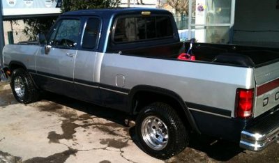

    To get 5-7" in the rear you flip the axle on top of the springs
    You can do this 2 ways
    You can use a axle flip kit for a 73-98 Chevy truck & universal shock plates or C,B,or E with a 8 3/4 or 9 1/4" rear end
    You have to grind the U brackets & weld them to the original perches
    Or you can use weld on spring perches from Mopar Performance & the same shock plates as above

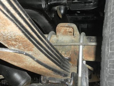

    As with any mods like these, there are other things that need to change also.
    If you do a axle flip you will need to move your parking brake lever & cable bracket up on the frame like in the pic This keeps it from dragging on anything

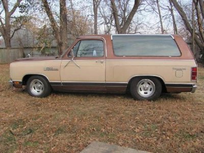

    Here's my RC with a axle flip & a van LCA. The tires are 225 60 15 in the front & 255 70 15 for the rear. I staggered the tire size to make up for the lack of Dak spindle for now

    Swwet merciful crap that's low. I love it!

    Thank You! My shorty will be 2 1/2" lower than that when I'm done with it. I like my trucks either lowered or lifted

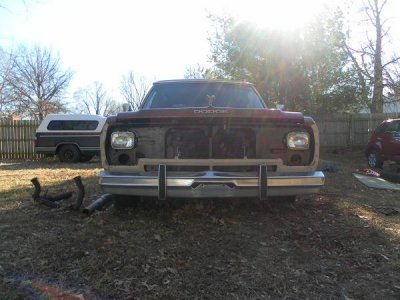

    I'm running the LCA out of a 93 D250 cummins truck in mine. It's got drop hangers on the back and I plan on flipping the rear on top of the springs. My truck isn't your ordinary shortbed though. :)

    The LCA from that Cummins is a 4000# LCA Welcome Dazed! How fast is your oil burner?
