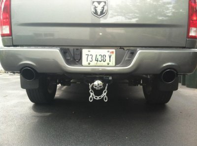

I just had 5" Black tips installed yesterday on my 2011 Crew Cab. I picked up 2 4"OD-3"(doesn't really matter because shop will flare the 2.5" pipe to fit the 3") reducers from Napa. Had my resonators removed as well. I am running a 40series Flowmaster and I can tell you that having the resonators removed changed the sound. It is louder and rumbles more. Prior to having them removed I was getting a slight drone from 1st to 2nd gear for a few seconds but thats it. Now the drone is gone but the rumble is louder in the cab. You will have to cut the corner off of bumper mounting plate depending on how tucked up you want the tips. The tips look bad ass.

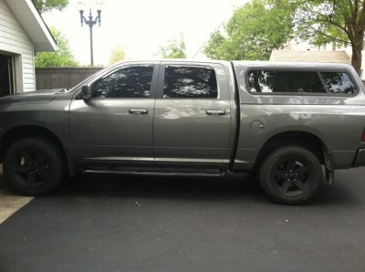

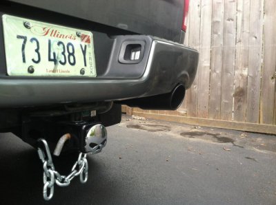

MRBP tips, bout $70 a piece, adapters were $34 install was $120
