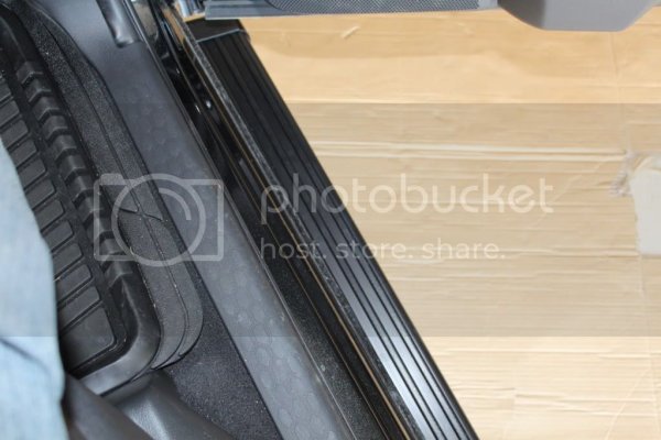

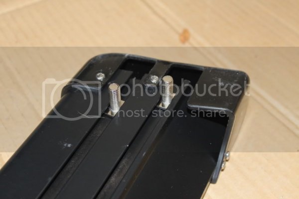

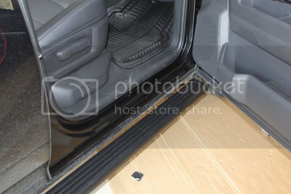

So I purchased some side steps for my 2011 Quadcab. Overall I give the installation a 8/10, quality a 7/10, price-to-value a 7/10. FORGIVE THE MESSY DIRT AND GARAGE:i_rolleyes:

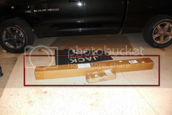

What you receive:
What you need to install:
What is inside boxes:

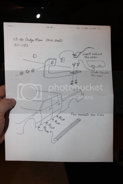

Directions

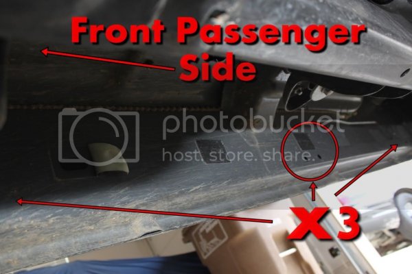

(They say to use 4 brackets per side, but I only found 3 areas and 3 seems enough):
Remove tape in 3 spots per side:

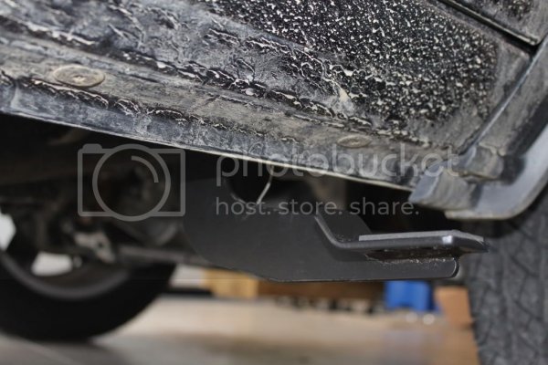

Insert welded bracket:
Install Brackets:
Install (2) bolts per bracket:
Tighten all bolts and then give them a good stepping on and then re-tighten.
