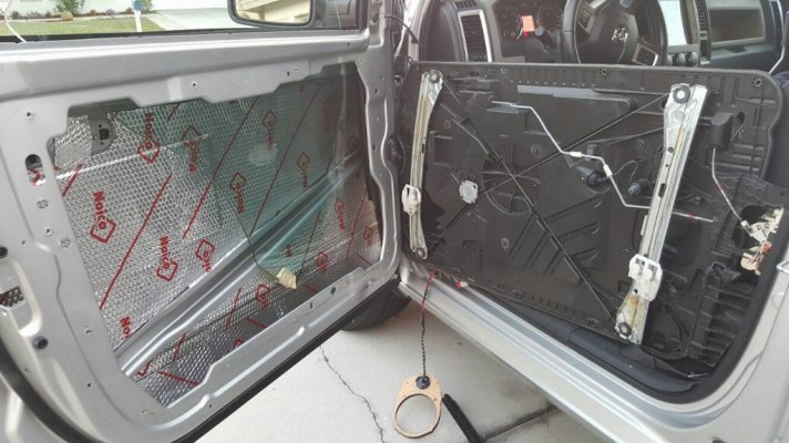

So I was asked to do a write up on how I removed my door inner door panels and windows to apply sound deadening. I will attempt to do this. I did this alone. It will be very helpful if you have a second set of hands for the window removal part.

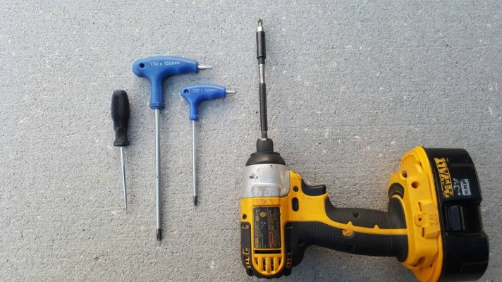

Tools needed are:
T30 torx driver
T20 torx driver
10mm socket
Small pick tool
Phillips head screw driver.

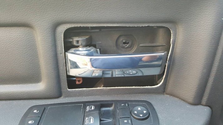

Remove trim behind handle by using the pick tool to remove cover for the Phillips head screw holding it in place. d53fb012a7f4307f017c2a74e978151c.jpg

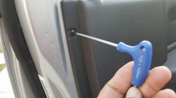

Remove all 7 plastic screws holding the outer panel in place with the T20 torx driver fc933612df49129a7688959e21cf759e.jpg

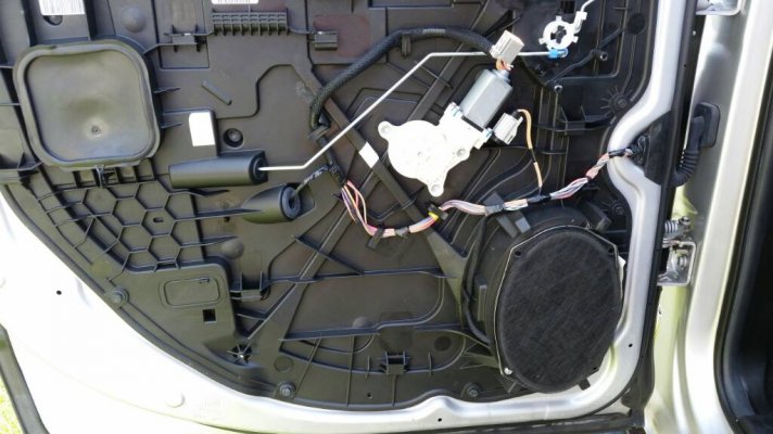

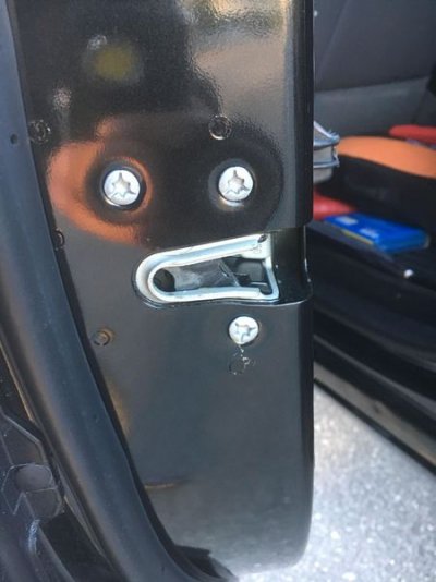

Remove the T30 torx screws holding the door latch.9a4466c70002017d2e2f934cf364659c.jpg
Unhook the door lock and handle rods from the latch.67a6bf1548b0f9f39f4b629207f43dad.jpg

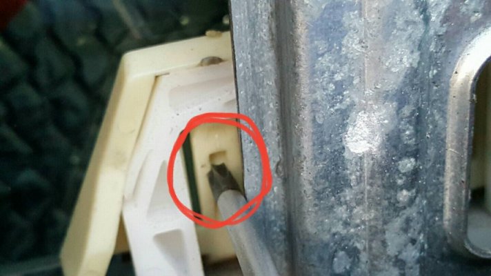

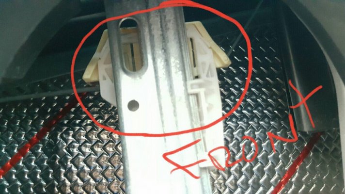

Plug back the window switch and roll down window until you get the white plastic holders aligned with the access holes on the tracks. Front hole will be behind the speaker and rear will be behind the square plastic cover.88f5cceb51bc88c7bcc4acf74ae9d598.jpg58ed713292197abd4436e4ee0b455b62.jpg
Using your torx driver, press on the release tabs to remove the window from the track. b522b177236e2cef3c6abb83ef186d84.jpg3d9be1be2339d1006f236b8fd3b7b2d5.jpg
At this point, remove the last screws holding the inner panel in place, slide the panel forward towards the front of the doors, slide out and put to the side. Please note that it will be much easier if you remove the wiring from the door panel. Unplug the regulator and door modules.8b06e47e2518633b32c5861da181dbc1.jpg
Now the window glass is detached from the track and it is sitting inside the door. Turn the glass 90 degrees and slide up and out. Easier to remove from the outside of the doors. Now you can do anything you want in there. Perfect time to replace door handles as well. b78a84613673868ce52d94af3171099c.jpgaee631fd6ac90a32d6eea7038750aff5.jpg

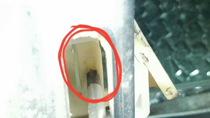

does anyone know what this is called or what would I use to remove this? Would a Torx bit work? I havent tried but figured since I am stuck at work all day , I would ask to prepare myself for what I need.

Nevermind, just went outside and checked and a T30 will still work.

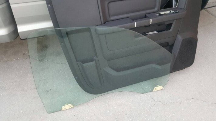

E1D462CE-EB74-4E5D-9DB6-171C0A06D15A.jpeg You’re write up was great!
It really helped me with the basics on my 2018 recently. In fact it’s still helping me. I’m only half done.
I did a 20% tint on my drivers side front window. Taking the glass out, after figuring out that the heavy duty felts in the door trim would present too much of a challenge for it to be perfect, I went with your instructions.
Minor differences I found on my ‘18 were 12-10mm bolt vs 13, no outside screw below door latch and my speaker looked different. So no big deal
Still only half done but when the ole lady comments the job looks factory, I have to give you the credit. Here’s a garage pic of the window. Sorry to the techies on board if the detail may be less then perfect.
