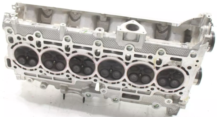

I have not looked too closely at the design of the Hurricane engine. I assume that it does not have a 'HEMI' design in the heads. My questions is - could it have been a HEMI? Should it be a HEMI? Does it make any sense in an in-line six configuration compared to a V8?
If it was good for the V8, why is it not good in the I6?

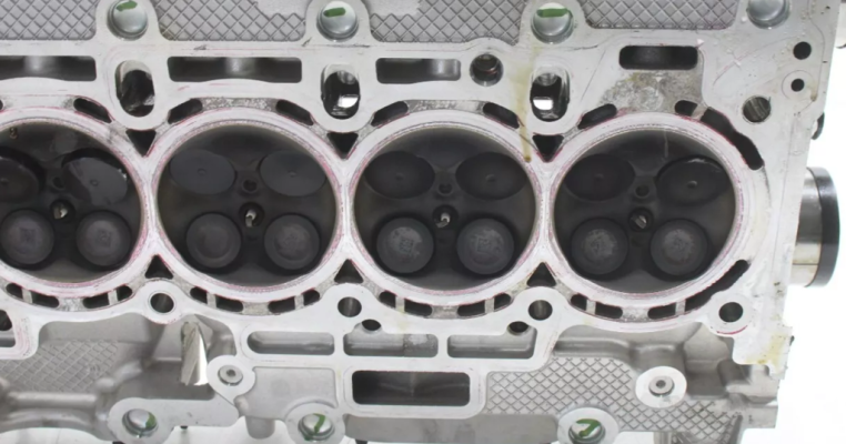

The Hemi head design while good for power, is not ideal for emissions. And, with turbo/super charging, the head chamber design is a less important factor in making power. The Hemi chamber design promoted moving air in and out of the chamber in both naturally aspirated and forced air systems. But for the street with emissions, up to 28 lbs of boost with forced air induction and still meet emission standards.
Since it has a 4-valve head it’s chamber is probably more of a pentroof chamber design which is still kind of a close relative of the Hemi.

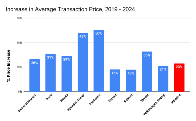

If you like paying 50% more for vehicles lasting 50% less, have at it. Not me.
Burla
Apr 28, 2012
27,514
57,688
2010 Hemi Reg Cab 4x4
Charge more and lasts less about sums it up, nobody prices have gone up higher then stelantis and this just scratches the surface, next 4-5 years they will be on an island. Kind sad considering they aren't known for quality with any of their brands.
