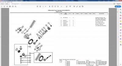

Looking for a rebuild kit or specific parts for 2003 Dodge Ram 1500 front differential. It’s the chrysler 8.25 ring with 3.55 gears. I need the intermediate axle shaft support bearing on the left side. Looks like a pin or roller style bearing and the right side looks like a copper bearing. I can find the bearing for the pinion and carrier but not the shafts that the axles spine onto. Please help somebody.

Does this help?

This is what it looks like, the right side intermediate shaft rides on there and the axle seal covers it up, then the cv assembly will spine onto that shaft. The left side has a normal bearing and these both have wear.

Well I posted a link to the actual parts book; get to lookin lol. Good luck.
I think the parts you are looking for are these:
BUSHING, Axle Shaft Right
52111167AA
BEARING, Axle Shaft Left
52069707
These part numbers are from page
# 36 of the 2003 DR Parts Manual.
52111167AA
This was it. It’s ordered and on the way.
