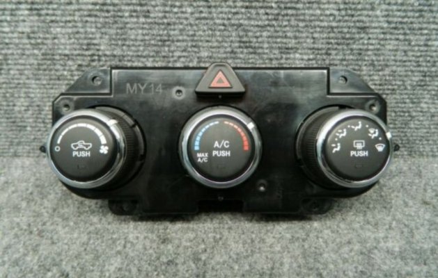

Ok so the air is blowing good but the temp control unit (hot to cold) may be bad. Its possible that a blend door actuator may be bad too Screenshot_20211128-101544_DuckDuckGo.jpg

Does this truck have the dual zone climate control or the ATC single zone mod?

It’s not my daily, I have a little car I drive around. It doesn’t have dual climate it’s a base model. CoolNt flushed last summer, new coolant bypass valve last summer.
Im stumped.
