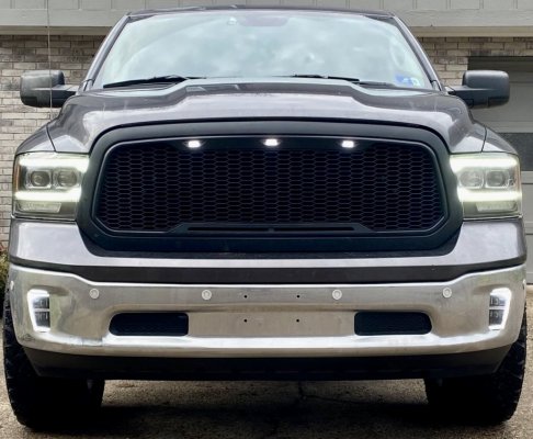

Those look nice!! I went with the old G2's. Now...I want the ones you got.
Do both of the white lights in your top picture stay on as DRL's? Is the light at the bottom the turn signal? If so, how bright is it?
With the two sets of LED bulbs, do you have any RFI or inference with your radio?
The two white lights and the one underneath are the turn signals. The white ones turn amber.
I only have led in the high beams, I’ve got HID in the lows. No interference that I’ve noticed so far. I made all the necessary changes in alfaobd.

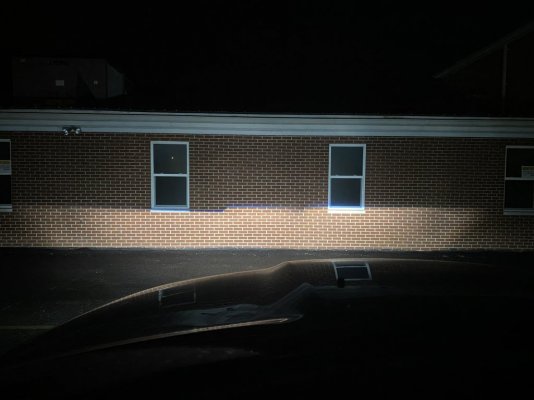

How do you like the 55w ballast with a 5k bulb color? Probably more like a 4500k color on the 55w ballast. Any yellow at all? Can you tell the difference in color between the led 6500kv fahrens?
I’ll check the HID vs LED color tonight. I wasn’t really worried about it…I don’t run the high beams all that much.
The HID doesn’t look yellow to me at all. I didn’t want any blue and am pretty happy with the 5k
Low beam against a brick wall

Sure does look white. You use the canbus setup or the none?
