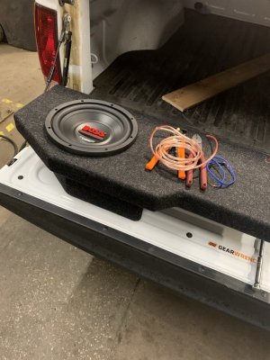

I started off with a small single 10” box on the floor behind my driver seat, amp under the driver side rear passenger seat, that worked well for a little while but then it was starting to get in the way having 3 kids back there and getting older.

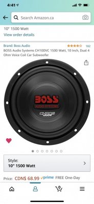

I then swapped to a single 1500w 10” Boss sub in an Amazon bbox which sits under the passenger side rear seat. I am using a 200w MTX amp with the speaker wired so that I get the amp powering it at max available power, and wow what a difference! Great bass, loud when I can really crank it (no kids in truck lol) and it’s completely hidden out of sight.
I used low inputs tapped into the rear door speakers, and remote power signal coming from the rear left side window, so I can hit the window kill switch on my driver side door controls and it will instantly cut the sub and amp out.
Over all very pleased with the sound and fit, in the future I may try going up to two 10” or two 12” speakers and a bigger amp, but for now this is plenty of bump for my daily commute needs.
