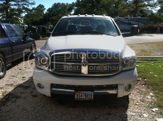

the bumper cover will fit over the chrome and doesn't need the sport beam to be installed. i've put them on two rams so far.
