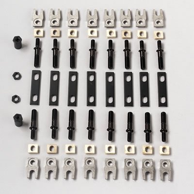

No drilling is needed if u use the right stud kit. Crane Rocker Arm Guide plate Conversion Kits 36655-16 needs no drilling whatsoever.
The pedestal mount HS doesn't require drilling does it?

$380 for the two kits vs $408 for the hs kit thats non adjustable. All prices are from summit.
