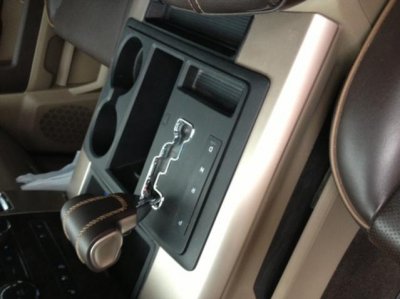

I was having problems with certain times of the day the sun would nail me in the eyes reflecting off of the chrome trim ring around the center console shifter. I'm sure alot of people have been blinded by this. I took a scotch brite pad and scuffed up the ring really good and cleaned it. Then primed it with flat black primer and painted it with flat black paint. Made a HUGE difference. I did this several months ago during the summer. Also I couldn't see out of my rear windshield very well because the rear headrests were too tall, so I had an upholstery shop shorten the headrests for me for only $40 a piece. Great bargain if ya ask me. They are as tall as my old 07 Rams were. They are still very functional and I can see ALOT better out of the windshield now. I also built a box for my rear floorboard to hold my crap. I cut it out in the front to clear the controls on the back of center console, vents and all. Just thought this might help someone with a couple of ideas.box.jpg

Sorry, I don't know why my pics get turned sideways?

Looks good. That trim ring has been an issue since the 4th Gens came out, pretty much everyone ends up painting them. However, the 2013 Ram still has it chromed! You would think Ram would have had changed it. Oh well....

Very nice. The trim ring hasn't bothered me yet. It has in other vehicles. I've wrapped them in 3M DiNoc before.

yeah I tried black vinyl first but couldn't get it smooth.

The chrome "Ring Of Bling" Was the first thing I did when I bought my truck lol.. as a lot of people have done due to being blinded lol. Funny how such a small thing could be such a PITA!
I never thought about hacking off some of the head rest. Nice touch!

all I've done is the shifter console ring and yes I did take it off to paint it. It just pops off with a little screwdriver or something. Be careful not to put too much pressure on the tan plastic around it cuz you'll scratch it. I dunno bout the vents etc. I'm sure they're the same.
