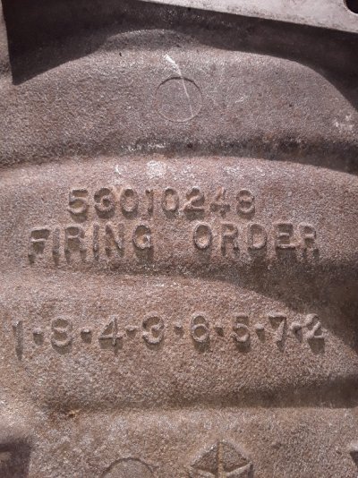

Well I don’t think I have the wires routed right I’m not sure. Imma have to look up that tsb again. Imma try a iac this evening and see what happens. If the dealer has one. I did clean the throttle bodie when this all started happening. Maybe the iac just doesn’t work like it should

There's a TSB for plug wire routing but your wires have to be on the right plugs first. Apparently listing the site upsets the forum god(s) so you'll have to google it. This TSB solves cross firing of ignition wires at the cap

18436572 clockwise rotation drivers side 1357 passenger side 2468 #1 terminal on the cap points at #2 cylinder bb787df410e0e89bf46e55631d1af1b8.jpg
