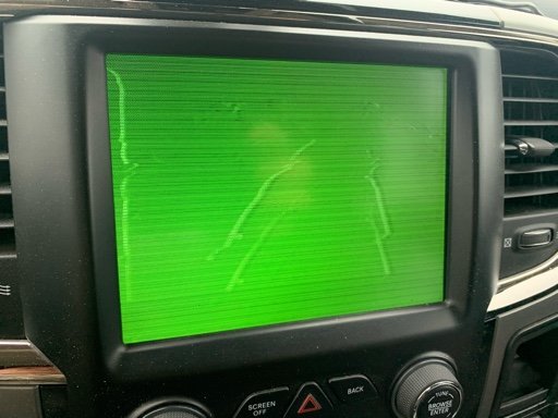

Is it toast?

Oh man, sorry you are having such bad luck with rams so far (IIRC you got this one after the first one you bought had some engine issues?)...any other issues or symptoms with the screen before this happened? Had my last ram (2013) have some similar symptoms like these, in addition to others, and yeah the unit was no good at that point. I ditched the truck and moved on, but was ready to do so anyway. If I were to keep it I would have most likely replaced it with something aftermarket, as these stock unit's don't seem to last especially long in my experience.
Other option I've seen as oppose to going with a stock replacement, is to take it out and send it to some company that can fix it. I just saw a thread about it here recently, I'll see if I can find it.
Edit: Saw in another post the company is called Navrepair...I know at least a few people on here have used them.

Might be the camera and not the radio itself.... start by checking the connection that goes between the tailgate and the truck bed.
Does it green screen all the time or blurry backup camera/ green screen just in reverse???

I've had issues like this before.Next morning I started the truck and it was fine

Well we got a storm last night with a lot of wind so it may have just been wet started the truck about an hour ago and guess what, it works again perfectly!
Yeah I was the one that had the problem with the black truck but this one seems to be really good hope so anyway but so far no issues.

If that’s the case, then check that plug between the tailgate and the truck bed.

Not too bad luck actually, I really liked that black truck but luckily enough I caught the issue before it caused me any headache. I don’t know what was wrong with the camera but the tailgate was facing most of the wind and rain from last night so it may have been that. I check the connection and everything looked fine. Just glad it’s working again!

Oh that's good, I couldn't remember the exact circumstances but I'm glad to hear it wasn't that bad. Also, I totally forgot about it just being the camera! Glad that's all it turned out to be, have had that issue from time to time as well but didn't even think of it for some reason.

The connection will work itself loose over time. After the 2nd time this happened to me I removed the cover on the tailgate and zip tied the connection in place. Haven’t had a problem since. Now I just need my radio to turn off when it’s supposed to [emoji58]
