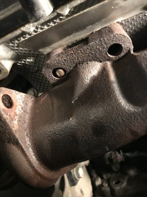

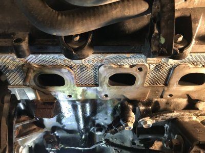

Hmmm I guess I should check the bolts, I was thinking it was a longer lived tick but I just went out and tried after sitting overnight and it really only lasts 30 seconds or so. Also sounds like it's coming from lower down on the driver's side of the engine which would be the exhaust manifold...

Lifter tick is louder and more noticeable, and goes away completely in a few seconds, unless its a failed lifter which would be persistent. You probably have a broken manifold bolt. I would fix it sooner rather than later to prevent the manifold from warping. Get under the truck and check the 2 bolts closest to the firewall on either side.

The one issue with exhaust bolts is you need to be careful fixing it because if you drill the region to far it is very easy to go into coolant passage, or maybe even oil passage. So use dealer, or if you do it yourself use one f these....

A high percentage of the time they will break(heat shield bolts) flush with the manifold flange and you can get vice grips on to remove.
If it is on the exhaust head plane, the best method is to build up a weld with a nut and washer as the heat will also break any corrosion formed. Drilling and *extracting is risky in that tight of an area with an extractor, but can be done with the proper tools.
