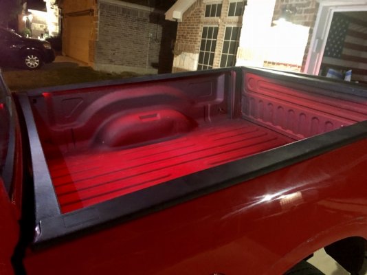

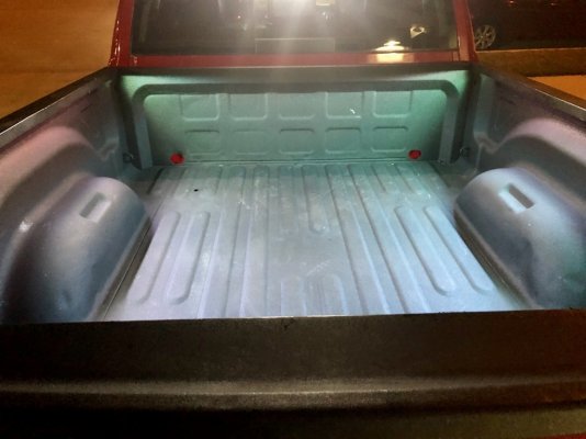

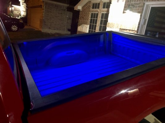

Very informative video walks you step by step through the splicing. I believe it’s a white with brown tracer wire located in the footwell you splice into. Check out this guy’s video. Worked perfectly for me
