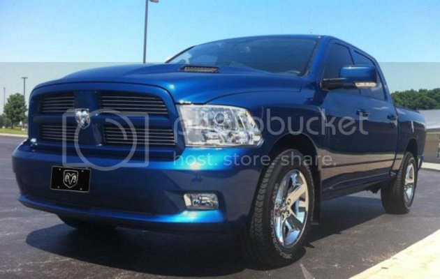

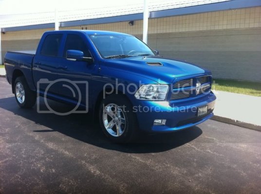

Wanted to show off some more of Jeremy's work.
My subtle projector retros. Like no other (that I have seen),
Thanks again Jeremy for all the help. I'll get the adjusted soon and send some pics of the cutoff.
Install was "pretty" straightforward. Getting the grille and the lights out are a chore, but nothing too bad. I struggled a bit with the wiring as Jeremy could tell you, but a little trouble shooting and an email or two on a Sunday morning and they were in.
On to the pics.
I love these things!

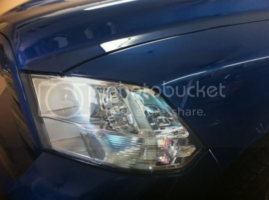

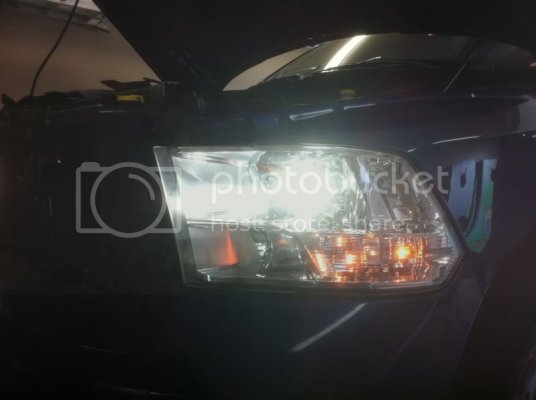

Thanks all. I love the light output of these things. I went with the 4300K HIDs and and will eventually switch to LED turns/parking to complete the 100% clear look. Right now I have the Silverstar blue bulbs which light up amber in there now. I can see a tinge of amber in there which needs to be addressed soon enough.
I can't believe how factory these look right out of the box. No one would know someone baked these lights, took out the reflector, put in some projectors and wired the whole thing up. Truly top quality work.

No, thank you. I never would have been able to pull this off on my own. I don't know how you make them look so good, but whatever your process, you've got it down pat.
Now if you could just predict how each truck will need to be adjusted before they ship, you could quit your day job. Better yet, mobile installs! I'm not too far away. Sure the family would love that!

haha - predict is right! LOL
I had mine dialed in, took them off the truck - put them back on.......wouldn't you know it - its off a smidge. There is some "wiggle" room on them with the factory connectors. Oh well!
Mobile isn't a bad thing, I've done 2 that way in the past - one in the works at the moment!

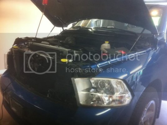

Hey gus you do know you dont have to remove the grill right i have a 2011 and had the headlights out like 5 times no need to remove the grill at all

Walt, I did not know that. I have taken off the grille a couple times in the last couple days trying to adjust these. I've gotten pretty good at it by now, but not having to take it off would be a lot easier. How do you get the lights out without taking out the grille?

you can get it out, if you have a long enough socket set. I tried once.......said screw it. The right tools make a big difference!!

best bet get a long extension and a deep socket shove some duct tape in socket so it grabs the bolt and boom (thanks to stacy davis from gearz) and no more removing the grill
