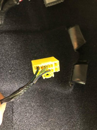

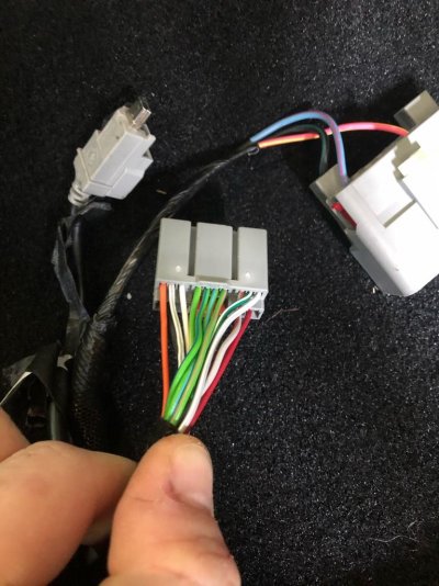

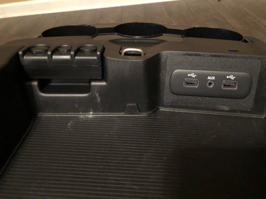

Looking to install some accent LED lighting around the jump seat/cup holders.
I haven't been able to find a pinout for the harness running through the jump seat to under the driver's seat. Hoping to find key'd 12v power and ground.
Jump seat media hub
Jump Seat side wiring harness:
Any help would be appreciated.

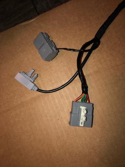

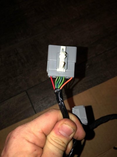

Truck side jump seat harness:
Driver seat harness:

Spoke with Mike (M2 Mods) and doesn't look like there is keyed 12v power anywhere in the harness.
I ended up building a harness from my amp remote wire and ground from behind the radio/HVAC bezel to under the driver's seat. Used a two pin connector and routed the 2nd half along with the OEM jumpseat harness. That way I can unplug the harness and remove the jumpseat if necessary.

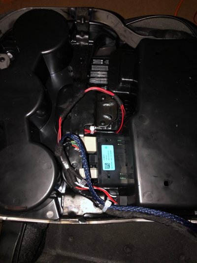

Picture of the underside of the jumpseat tray. Wires coming in from the cupholder LEDs to a dimmer switch, output harness (blue shielding) running out to the bottom of the jumpseat.
