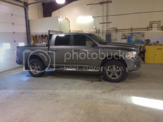

I just finished installing bilstein 5100's on the front of my truck to level it out. I had previously installed the TTC-1223 rear coils and it gave the truck more rake due to the stiffer coils, so after I did some research decided to go with the 5100's.
The nstall was not that bad, I have a compressor so I didn't want to pay someone to do it. When I first drove it after the install I was in 4x4 and got a little bit of a shake when accelerating, but it went away quickly. I then switched to 2x4 being on the highway and never got a shake when accelerating. Has anyone had any trouble with Shaking in 4x4? Also at times it sounds like something could be loose, but I have triple Checked everything and its all tight. I will have the guys check it out when I get it aligned Monday but it could just be me I guess.
Anyway, I think these shocks were the right fit. Don't really have any good before pics, but here is after.
