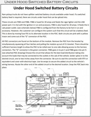

I added a tap-a-fuse to #92 for my aux project. it had a fuse, not a blank, wired fuse though.

When I got my 2018 below is what I found and tapped in under the fused distribution panel. Not sure if it carries over to other years.
