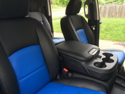

For me, the clazzio's were not even an option. I think they look like pooh. But yeah, you take it down to foam. You take hogrings out and reattach new covers. For only a few dollars more, you have a great looking set of custom skins that you can personalize based on the 800 I paid for mine.

Very nice deangtp, one thing I have to ask though in your picture I noticed a ripple in the jumpseat side piece, I also noticed that on ricks ram as well did that come out?
deangtp
Aug 13, 2014
208
63
I need to adjust the way it attaches. The other side is perfect. I actually forgot about it, but yeah I think the wave/wrinkle is still there. The stock cover has a J-clip that snaps into the channel. The aftermarket skin has piping that is poked into the channel.
