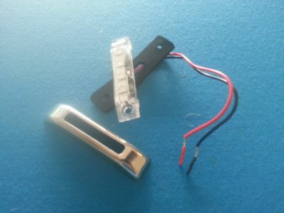

This is the light I used.
I took the cover off the radio and heat/ac controls and removed the cubby hole tray. I mounted the light inside on the top, about a half inch in with 2 small screws up into the plastic. You need a small hole for the wires to thread up through in the center of the light but it will be covered by the light. Then it's just a matter of finding a power source to wire into. My truck has a plug that goes into a fitting just to the right, but it's for some option my truck don't have, and it showed power with my meter so I spliced into it.
