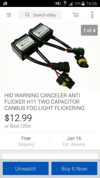

This is what I used to connect the led light bar to existing fog harness.
Is this what I need to eliminate the flickering .?

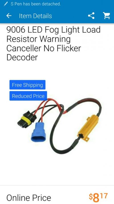

Or this one ?

I think the 12.99 one is more what you would need. But I don't know for sure.
Bah just saw they say 9-14v. I don't know.
