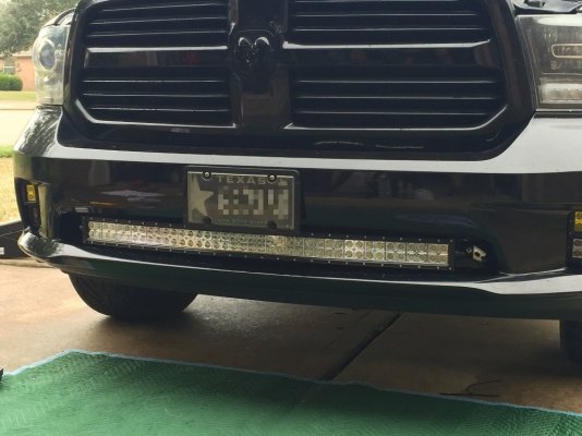

I upgraded to a 42" curved LED from a straight 34". The difference is definitely noticeable!!
I purchased a Shanren 42" LED 240 watt bar from Amazon for $95 shipped. It was recommended from someone on here, as I was looking for one that would not leak and get condensation. Since I have had this, we have had plenty of rain and temperature changes, and so far, I have experienced ZERO issues with fogging up or anything!
Here are some pics of my install and how I attached it.

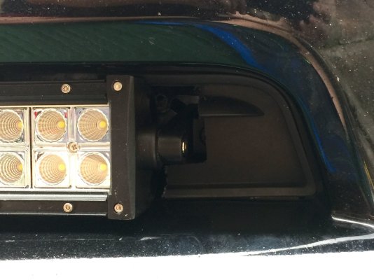

From the front, you can see the bracket.
From the backside - I used one of the bumper mount bolts. I had to bore out the bracket a little for it to fit over the bolt. I also had to use a cheater bar to break this nut loose! It was freakin' tight.

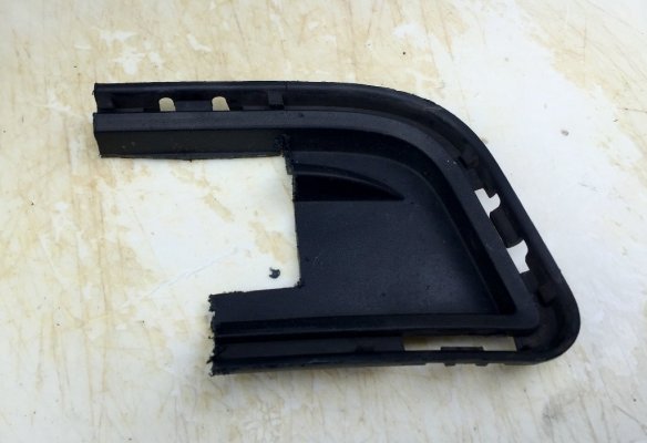

I trimmed up the insert to cover the bracket from being seen:
All buttoned up:
Output shot...this is the LED only!

I moved the license plate up a little bit...maybe 3/4".
The black insert pops out easily. Just get behind it from underneath and you can pop it out. There are several catches on it, so just take your time. I put the on/off switch on the drivers side in the panel down beneath the headlight switch. I just used a small rocker for now. Going to do a switch from OTTRAW eventually.
