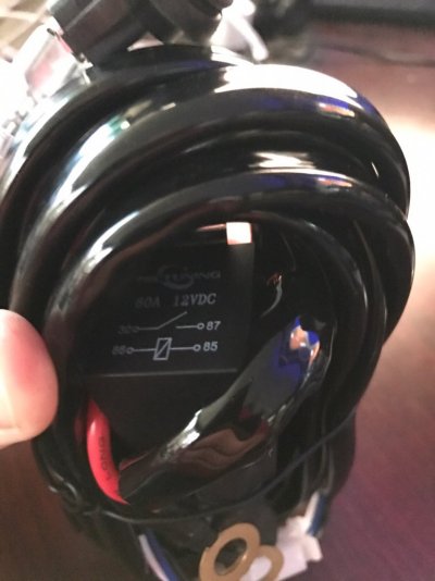

This is what the light bar comes with, male and female connectors. You then connect it to the wiring harness.

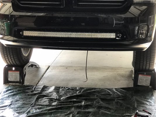

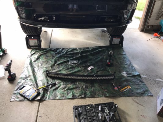

It's a Phillips light bar. Here is the link.

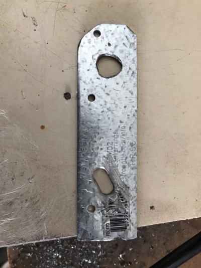

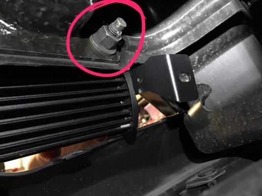

The bracket I made from flat bar that I purchased from home depot. I connected the bracket to the front bumper bolt.
For the wiring kit I used : MICTUNING 12 Gauge 600W HD+ LED Light Bar Wiring Harness w/60Amp Relay
Since installing, have you noticed any paint damage to the area behind the light bar. I currently am running a bull bar with light, but am wanting a cleaner look. I also wonder if the way you mounted the light will work on the two piece bumpers
