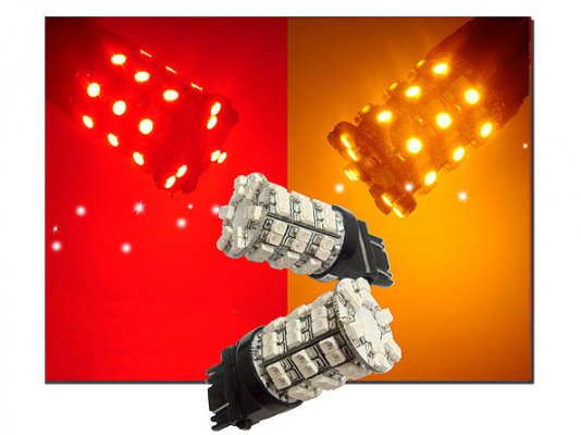

Whats up guys, yesterday I saw a ram with crazy sick LED lights that were running white and then went to amber when signalling.
They looked like..
Anybody know where I could get a pair that would work aside from the ones JJ sells??

Those will work just make sure to mount the resistors on metal. They get hot and will burn plastic.

whats wrong with mine? LOL
I know they are brighter with their design vs the ones with a bunch of smaller LEDs on them

You have to wire the resistors. One side to hot other to ground.

Okay so I got them installed. however my dash is saying they are out and yet they are functioning however they are flickering a little bit fast. Any ideas?
Thanks guys.

Sounds like the resistors are not working properly.

I never used them just plugged them into the previous signal bulb was and it worked.

Well that's your issue right there. The bulbs will work without the resistors. The purpose of the resistors is to eliminate the light out message.
