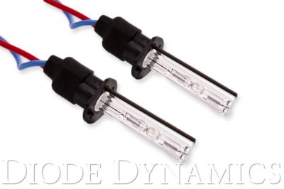

so i currently got HID kit in my truck and its the worst...had for a few years different brands and they have just let me down...bulbs not turning on...1 on 1 off....randomly dimming?...tried a $500 kit..failed me...$200 kit..so on so on..im annoyed....what is a hassle free LED bulb that will suite me....i have aftermarket headlights....spyders...so they have that weird metal clip thing...but anyways yeah...i need a led that will work and be reliable... not flicker or whatever....2015 ram sport. (had OEM projector headlights) swapped with spyder headlights. (projector also):confused::mad:
My projectors currently take a H1 bulb.

these are whats currently in
