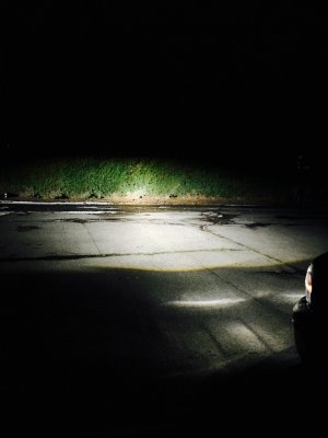

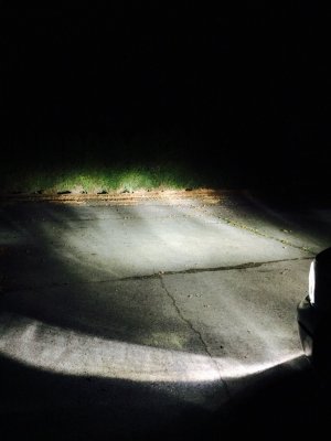

A couple of output pics. Still not aimed but I'm just going to live with it until it warms up. Thinking about painting the shrouds..,

I'm not all up to speed on the "HID" headlight thing.
So I was wondering what is "HID high/low" and "Projector high/low" mean?
Are they 2 sets of driving lights? The projectors look like they have better output...
I understand you said you didn't aim the HID in yet though.
Just curious because again, I have no knowledge on headlights lol
