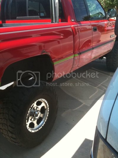

Well today the Mega went to its new owner and I was bummed . Was going to go the the fair but decided to just get my mind off the ol girl ans start on the CTD .
I rhino lined the new bushwachers and UV top coated them .
Sanded the rockers ... need to por-15 the rust ... but sanded all that rust down to metal . Then roll the rhino on the rockers .
When all said in done this body will be better than new .

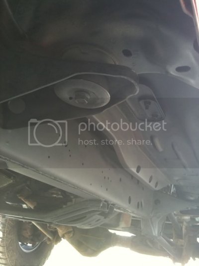

I did the undercarriage also.

Under body coating done

wow that looks nice. whats your steps for doing it under the truck?
Sand , Primer , Seal ...
The key is to sand all rust ... then primer than seal with a good undercoating material .
