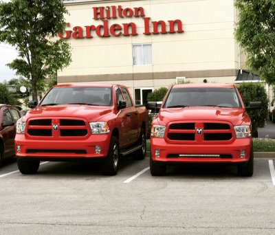

Little late to the party here, but I went with the 2.5" leveling kit which brought the front up 2" and the back "down" .5" and can still get into my garage on stock tires.
Here is a comparison of stock on the right vs leveled on the left to give you an idea of height difference

What size tires on the leveled one in the picture?
