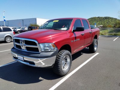

Hey all. I just bought my first Ram pickup. It's a 2014 1500 with the 5.7 liter engine. Same color as the one in the pic. Mine is stock, but the pic below is one that I almost bought. I like the ride height of the one in the pic and I was wondering if anyone had a confident guess on the lift height and tire size. It is a 2012, if that matters at all. Sorry it's not a better pic. The dealer didnt know how much it was lifted and I couln't read the tire size from the pic. I figured an educated eye might have a better guess than me. Thanks in advance. 20180423_115646.jpg

6" 35 in tire. Should have got it.

I'd say 6" lift on 35" × 12.50" tires as well ...
