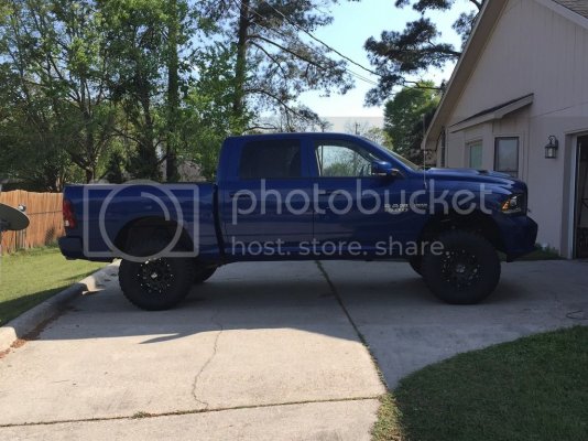

Just finished installing a zone lift today.
When I took it out around the block i had a few issues.
First the steering wheel is off center by about 30 degrees. Any idea how to center it?
Next the Traction Control light keeps clicking on and applying brakes. Could this be because of the steering wheel not centered? If not any idea what it could be?
It looks great though!!

I would assume you just need it aligned at a shop. I had same issue with level and bigger tires. Your truck looks sick! I'm guessing blue streak?
