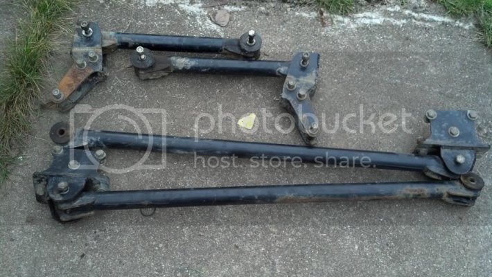

This is the Fab-Tech long arm kit. I like the upper control arm bracket much more over the BDS or Skyjacker ones as these are made out of thick steel and are inserted over being a metal wrap over the old upper arm brackets like BDS and Skyjacker use.

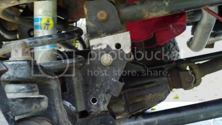

Top cut off the factory upper control arm mount, ready for the Fab-Tech mount.

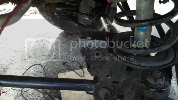

Upper control arm brackets being installed.

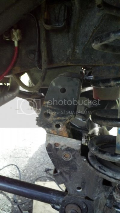

Fab-Tech upper control arm mount's.

Can the fabtech control arms be bought separately from a whole lift kit

Thanks to Johnn123 we found out they can be ordered direct from Fabtech.

I picked up mine with a bunch of other parts used so I have no idea what they cost new, drop Fabtech a email with the part numbers below and I am sure they will help you out.
1 EA FT3400-106DBK RR LINK BAR BRKT DRVR
1 EA FT3400-106PBK RR LINK BAR BRKT PASS
2 EA FT3400-107BK FRT DIFF LINK BAR BRKT
2 EA FT3400-108BK UPR LINK BAR
2 EA FT3400-109BK LWR LINK BAR
