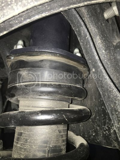

2017 Ram 2500
Attached is the photo of the strut assembly. It appears the ship installed the preload spacer. Is this correct. I thought with Bilstein 5100s you weren't supposed to install the preload.
