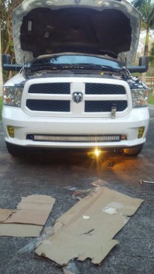

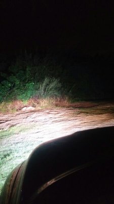

We all know 4th gens dont have great visibility when it comes to lighting, so i bought a 40" curved 240w led light. Installed brackets right to bumper support. Major improvement for $86 and couple hours to mount.

i have a 2015 sport, will i be able to do the same setup like this? i also dont have tow hooks. how did u mount it tho?

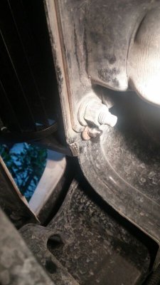

After i took out the black plastic, i centered the light in the gap with brackets already on it and marked the holes w a pencil. I drilled straight in to the corner of the bumper support right next to the big nut that holds it on, w a 1/4" bit. You have to mount the brackets alone and loose first, then the light, and then tighten everything up. USE LOCKWASHERS! It came w a wire harness which was easy pickings too.
