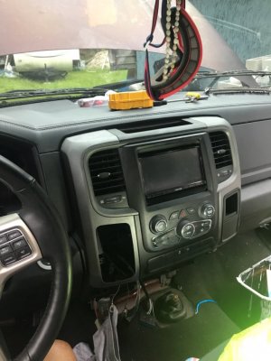

Need to know the wiring diagram by colors for a 03 3500 and the same diagram for a 17 1500 just did a dash conversion and wanted to wire up the switch

Vague as **** lol...so you swapped the dash (cluster, or the entire dashboard?) from a '17 to an '03? What specific switch are you trying to wire up, as I suspect you'd have to try to wire up quite a few things. The '17 cluster won't be compatible with your '03 electronics if you're trying to use it.

The cluster screen i dont care about the the basic mph the rpm the gas temp oil pressure gauges thats all
But the light switch is what im worried about for now j just cant find wire schematics on either truck
And i swapped the whole dashboard

Cluster means the whole thing, not just the LCD screen in the middle. As I said, not compatible (2nd gen CAN bus is not compatible with PCI bus).
