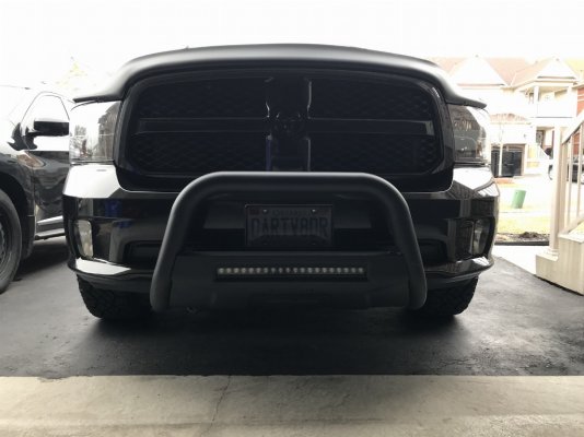

Skip the bar and get a bull bar with light!
The install is really easy. Or it can be hard. Depends on what you want to do. If you install with a wiring harness from amazon etc it will be straight forward. Mictuning has harnesses And instructions. They will also reply with email quickly.
Mods: EGR matte black bug deflector, Westin HDX drop steps, rough county bull bar with 20” LED, custom made NW seat covers in real tree camo, husky liner mats, husky liner mud guards, undercover LUX tonneau cover, Tailgate assist, flowmaster super 40 with resonators, tinted 15% front, LED C shaped tail lights.
