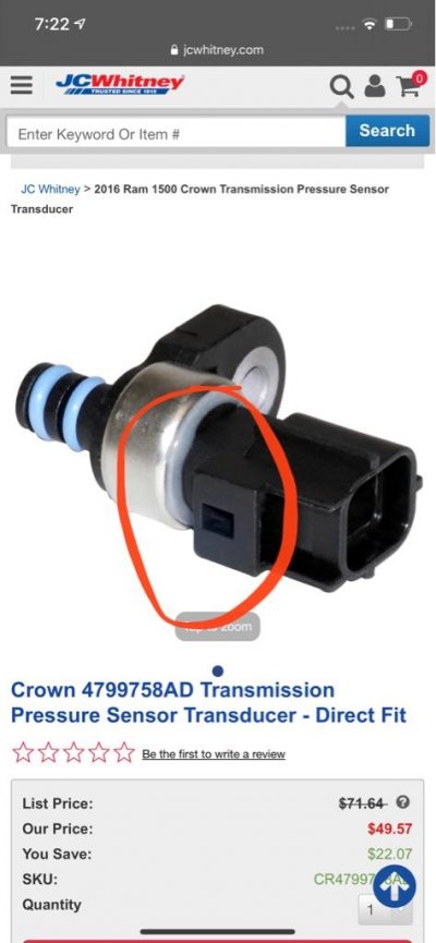

Did you break the pressure sensor housing? Is there a screw above the connector that holds the sensor into the transmission case? If so you can remove that screw and then the sensor. Obtain a new sensor from your local parts store or dealer.
This is where it broke.
